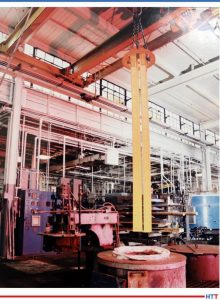

Heat treatment of long parts
Source: Cincinnati Steel Treating
The company was founded in 1941 to accommodate the gear industry’s metal-treating needs in the Cincinnati, Ohio, area. By 1950, they had diversified and moved to 5701 Mariemont Avenue in Cincinnati. Now, after two major expansions, the 45,000 square-foot facility provides heat treating services nationwide. Some of these heat treat services include: carbonitriding, FNC, sub-zero metal treating, and tool steel processing. The dimensional capacities of their furnaces accommodate large loads of smaller parts as well as parts too large for most furnaces. For example, their pit furnace vertically processes parts up to 120” to prevent warpage, and the max capacity of their car bottom and nitriding furnaces is 8’ x 17’ x 6’ and 57” x 107” respectively.
