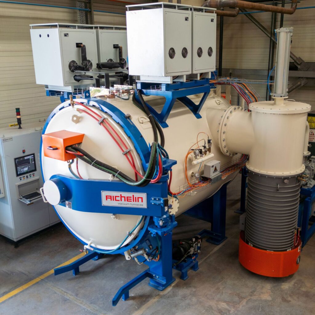

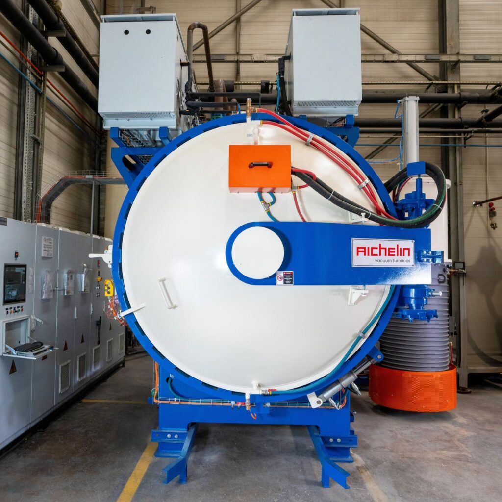

A leading aerospace specialist has received a high-precision vacuum furnace. The system was specifically designed to meet the particularly stringent requirements of this sector with a hot zone of 900 x 1200 x 900 mm.
Aichelin will provide furnace, which is equipped with high-grade insulation made from molybdenum and stainless steel, as well as a multi-zone heating control system.
The furnace has a dual gas supply system with independent lines and valves for nitrogen and argon. The separate gas supply provides reproducible, stable, and precise quenching operations. Additional features include 10 bar quenching pressure, up to 10⁻⁶ mbar vacuum level, and below 10 micron leak rate.
