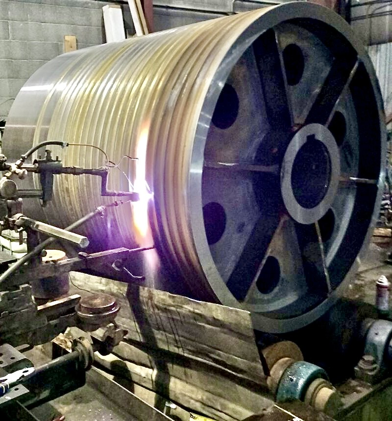

Large rope drum for offshore oil rig at Cleveland location

Main image: Matt Geddes, regional operations manager, flame hardening a roll at the Detroit location
