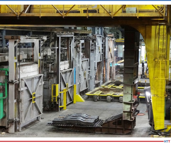

Complete Heat Treating was established in 2007 and has since acquired an additional two companies, increasing the company’s capabilities and markets. In 2011, they acquired Wisconsin Steel Industries, which was in operation since 1939. In 2018, they then acquired Commercial Heat Treat. After the acquisition in 2011, major rigging projects were undertaken to move furnaces, presses, and
other equipment to the present-day site in Milwaukee. One of the largest items moved was a large 53-foot car-bottom furnace.

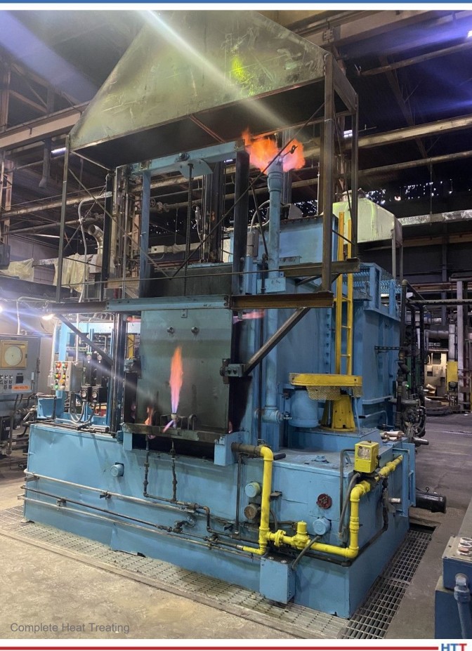

A few of the company’s services include those in heat treating, blasting, coating,
straightening, and hardening. Heat treating capabilities encompass a wide variety of applications and part sizes. They offer stress relieving, annealing, quenching, tempering, and normalizing of parts up to 53’ long x 18’ wide x 15’ high and weighing up to 100,000 lbs. Open fire furnaces are available in multiple sizes and can reach up to 2200°F with heat outputs of 40,000,000 BTUs. In addition to having metallurgists on staff, other services offered are abrasive grit blasting, oil preserve coating, close tolerance straightening, and portable hardness testers.
Although all processes are important, control of the furnaces with properly calibrated pyrometry is critical to achieving quality specifications. The ability to successfully process the extreme size, shape, complexity, alloys, and quantity of parts is a unique feature of the company. They commonly heat treat large, heavy-section (10–20 ton) plates; 5,000+ tiny stampings weighing ounces; and finish machined precision parts with close tolerances. They can anneal, carburize, flame harden, straighten, blast—all to one part!
