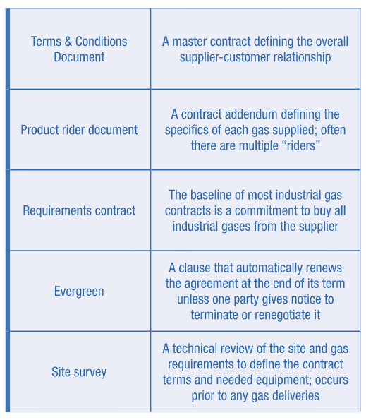

If a business requires industrial gases, it probably will have a supply contract. Insightful negotiation and active management of the industrial gas contract is key to reliable, cost-effective industrial gas supply. Industrial gas contracts generally consist of two related documents:
  1. Terms & Conditions: This document describes the relationship between the client and the industrial gas supplier (generally one per client).
  2. Product Rider(s): Often more than one, these individual sections describe the specific contract considerations and economics for each product purchased.
The terms and conditions and the product riders will each have a start date and a term (determined by the specified end date).
Industrial gas contracts are generally continuous: they will automatically renew unless cancelled in writing by one of the parties at least one year prior to the renewal date. Note that the effective date and contract term of the boilerplate terms and conditions contract may differ from the product riders — one document may expire before the other. For example, the term (and therefore the required cancellation date) for a nitrogen supply agreement is determined based on the expiration date for the nitrogen gas rider.

If neither the client nor supplier cancels the contract in accordance with the cancellation requirements, then the contract enters the “evergreen” stage at the end of the contract term. Evergreen is a rolling one-year extension of the contract that repeats until the contract is canceled in accordance with its cancellation requirements. Having a comprehensive understanding of the terms and conditions of the contract is necessary to avoid unintentionally missing the cancellation date and falling into the evergreen stage.

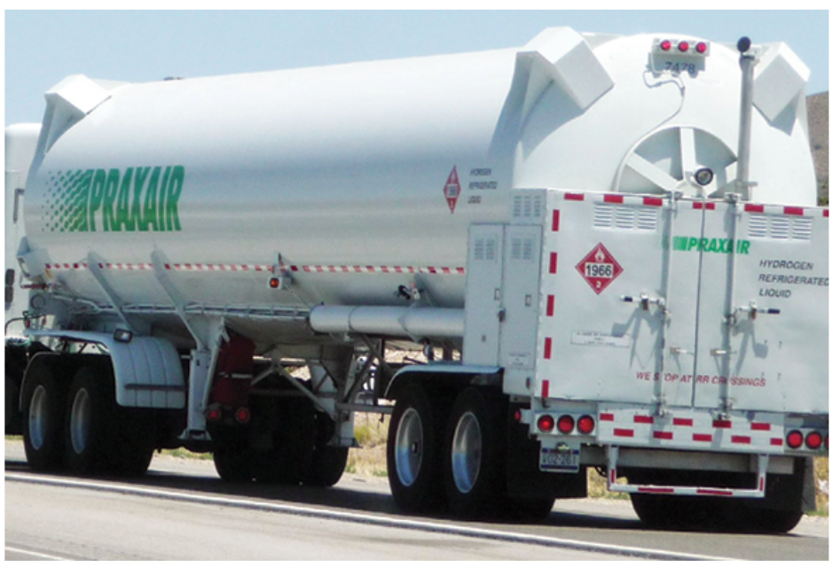

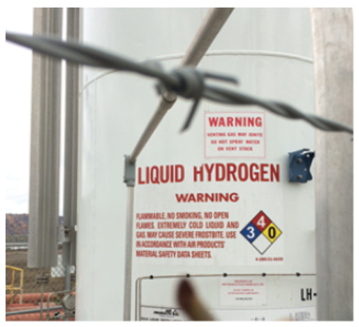

Recovery of costs and generation of profit are the goals of the industrial gas contract. As most thermal processors use bulk gases, stored as a liquid or as a compressed gas, these are delivered in bulk form. A trailer is sent from the supplier and the liquified gas in the trailer is pumped to fill an on-site tank, or the full compressed gas trailer will be exchanged in place of an empty trailer. In either case, there are equipment and delivery costs incurred.
Liquid hydrogen trailers can carry up to 13,000 gallons of cryogenic liquid | Image Credit: Dave Wolff
Both compressed and liquefied gases may be delivered and stored at customer sites | Image Credit: Dave Wolff

Paragraph one of the terms and conditions section of most industrial gas contracts is titled “Requirements.” It is important to read this paragraph carefully and ensure full understanding. Unless it is modified, Requirements typically obligates the client (“Buyer”) to buy all of their present and future needs (“requirements”) of all industrial, specialty, and medical gases to all of the client’s present and future locations from that specific industrial gas supplier. It also restricts the client in their ability to eliminate gas deliveries by switching to on-site generation unless they work with the contracted supplier.

A site survey is the first step in a contract negotiation. It’s important for the buyer to understand that making the tank available for deliveries is the buyer’s responsibility. The best (and least expensive) delivery infrastructure allows the gas delivery driver to pull through the site, entering, unloading, and exiting the site without needing to back up. Flammable gases require certain minimum clearances; the greater the quantity stored, the farther the distance required between the tank and areas of occupation and site borders. Oxygen cannot be stored close to flammable gas. In the case of snow, the delivery driver is not equipped or permitted to dig out your tank.

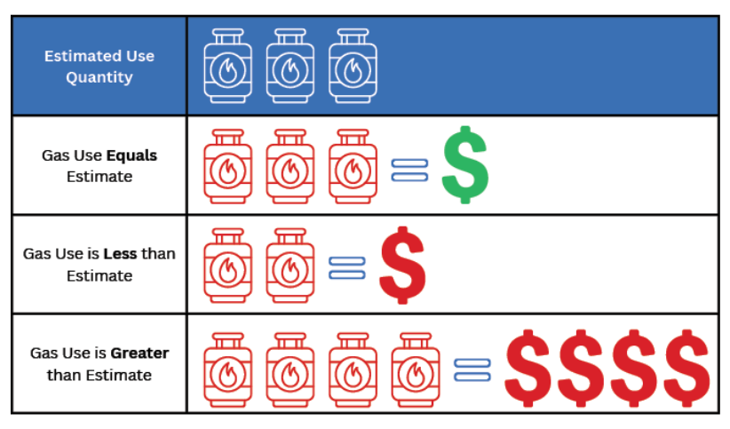

Another characteristic of many industrial gas contracts is the “estimated use quantity,” typically denominated in standard cubic feet per month. The purpose of this is to allow the supplier to understand how much product they need to reserve for your use. Suppliers cannot sell more than they make, but they are highly incentivized to sell out everything they do make since industrial gases are difficult to store. Buyers may be asked to estimate their monthly use quantity; the resulting estimate may become a contract variable. In essence, the supplier is acting to reserve the quantity of gas the buyer has nominated (and the assets to deliver it), and the buyer is indicating a willingness to pay for it.
If the buyer uses substantially less than estimated, the supplier may increase the price per unit. Alternatively, if the buyer uses substantially more than estimated, the supplier may not be able to provide the necessary amount or may charge a premium to do so. Estimated quantities are a particular concern for supply-constrained gases like argon and helium.
