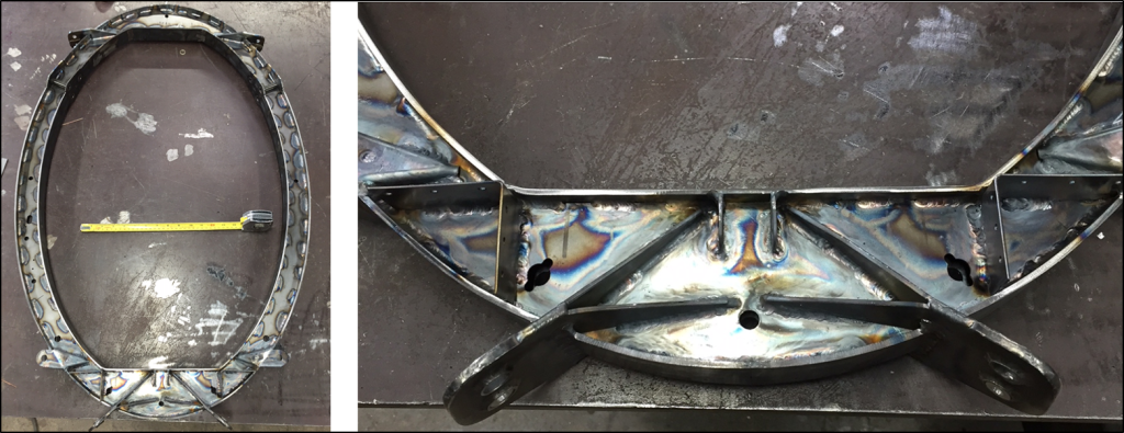

Classic Metalcraft recently turned to Metlab for the heat treatment of a newly fabricated structural bulkhead for a Ryan ST-A historic aircraft (circa.1934). Ryan Sport Trainers were the aircraft of choice for sport pilots, flying schools, and the military of other countries.
“The most difficult part that needed to be fabricated was the #2 bulkhead,” said David Paqua of Classic Metalcraft. “Not only is it tough to replicate without heavy pressing equipment, but it requires heat treating by a knowledgeable firm to prevent distortion.”
Bulkhead component prior to heat treating
The bulkhead component is a structural piece fabricated with 4130 steel and located just forward of the instrument cluster, where it bears significant stress. Metlab’s heat treating capabilities ensured that the shape integrity of the part was maintained as well as the aerodynamic characteristics of the aircraft.
