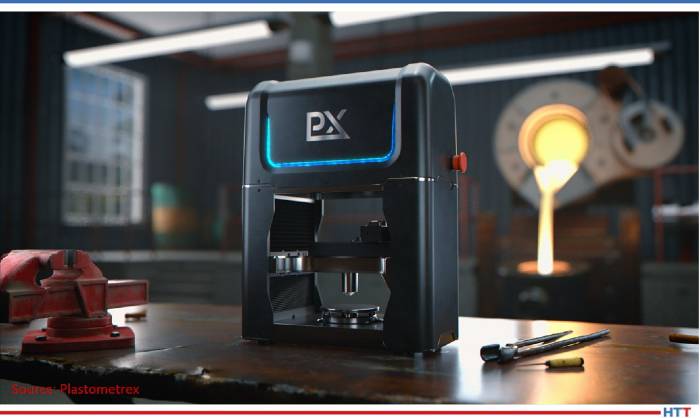

Heat Treat Radio #58: Indentation Plastometry with James Dean of Plastometrex
Heat Treat Today publisher Doug Glenn and James Dean of Plastometrex discuss indentation plastometry, a new technique for obtaining important mechanical property values for a wide variety of materials. The company’s equipment is just barely 6-months old and is already finding its way into heat treat applications in North America.

JD:  Plastometrex is a company that develops novel mechanical testing systems that are powered by advanced software tools.  By advanced, what I really mean is state of the art modeling methods, things like finite-element analysis, optimization algorithms and also, forgive the buzz words but, machine learning tools, as well.  These are needed because our machines measure stress strain curves and metal strength parameters from quick and simple indentation tests.
There is some justification to say that people have been indenting materials for centuries and, of course, that is true.  But people have been doing this simply to measure hardness numbers, predominantly, at least.  We might argue that anybody that understands a little bit about hardness testing probably also understands that hardness numbers are not fundamental material properties.  They would understand that a material's hardness number actually changes if you change the shape of the indenter that you use or if you change the load that you apply.
Hardness numbers can only really be used in a semiquantitative way to rank materials.  They can't be used in a design calculation or in a finite-element analysis.  So, to use them as proxies for strength, which is often done, can, in fact, be potentially dangerous.  I would go on to say that, unfortunately, hardness numbers are often accorded a much higher significance than they really deserve.  My own view is that it is much better to have access to fundamental strength characteristics which is why we've been spending our time developing these new machines and their associated software packages.
So, to wrap up the question, the technique is called indentation plastometry and it was developed over a  10 – 12 year period of research, led mostly by Professor Bill Clyne and his research group in Cambridge.  On the back of that, we established Plastometrex in late 2018 to commercialize the technology.

JD:  The current gold standard for mechanical testing is the uniaxial tensile test.  To us, at least, that is another mechanical test that hasn't fundamentally changed for almost a century, actually.  In principal, it is a rather simple test where you take a test specimen in the form of a testing coupon and you stretch it (or strain it, to use the proper term), and you do that until it breaks.  If you monitor the forces in the displacements during the test, it's very easy to calculate the stresses and strains within the sample.  But, there are a number of problems with this type of testing machine.
The first is that you need to have access to quite a lot of the material that you want to test because the test specimens are usually quite large, often in the centimeter dimension range.  That also means that the material that you want to test needs to be machinable, and not all materials are; I'm referring mostly to metals here.  In fact, some are actually quite difficult to machine so that this process of machining test coupons can be quite a cumbersome one.  Often quite time consuming, too, especially if you need to outsource these procedures.
The test itself also requires access to a large, often very expensive, universal test machine, and, in addition, a suitably trained technician, as well.  There can be further problems with things like specimen gripping, alignment of the specimen, machine compliance, and other things like that.
Whereas, and of course I'm biased, a machine like the indentation plastometer, really combines the very best attributes of hardness testing, which is speed, ease and simplicity of testing, with the very best attributes of tensile testing, which is acquisition and access to forced stress strain curves.
I would add to that, as well, that with a machine like ours, you can test real components and you can map spacial variations in properties across surfaces, such as those, for example, that might exist across a weld.  Again, in summary, we think you get the best of both worlds with our machine and, in some cases, even things that are better than other machines.

The testing process is fully automated and involves three simple steps. The first is the creation of an indent using the indentation plastometer which is a custom-built, macromechanical test machine (Figure 1). The second is measurement of the residual profile shape using an integrated stylus profilometer (Figure 2). The third is the analysis of the profile shape in a proprietary software package called SEMPID, which converts the indentation test data into stress-strain curves that are comparable to those that would be measured using conventional mechanical testing methods (Figure 3). The entire procedure takes just a few minutes, and the surface preparation requirements are minimal.
Another advantage over conventional tensile testing is the ability to map spatial variations in mechanical properties as well as the ability to test real components. In fact, in a recent project conducted in collaboration with Energy Densification Systems, a South African company servicing the mining industry, an indentation plastometer was used to characterize the change in stress-strain behavior that took place within a Hardox steel component subjected to high temperature during a brazing process.
Figure 1. The Indentation Plastometer from Plastometrex.
