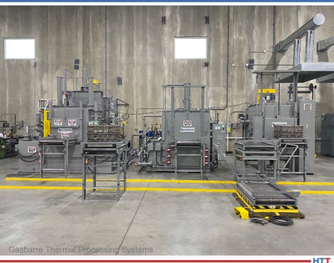

HTD Size-PR LogoAn integral quench furnace line was recently commissioned to a manufacturer of specialty nut and bolt assemblies in the eastern U.S. The furnace design will help the client increase their load size, allowing for higher throughput per load.
Gasbarre Thermal Furnace System's integral quench furnace system
The Gasbarre Thermal Processing Systems furnace line includes an integral quench furnace, parts washer, temper, and associated material handling and load storage, and it is designed to process 24” wide x 24” long x 20” tall loads weighing up to 1,500 pounds. It includes custom designed material handing that will eliminate the need for cast base trays.
