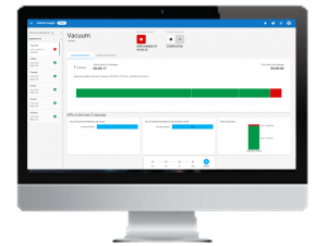

Digital Dashboards (Photo Credit: Eurotherm)
PS: Let me rewind the clock a little bit to when I first started in the industry and you had manual process cards.  Not a lot of paper chart recorders around, and those that were around were probably just logging the temperature rather than any other data point.  That has really changed.  From the 2000s onward, you’ve had paperless charts within the industry, SCADA systems, a lot of information.  So you’ve gone from this scarcity of data to data overload.  As you’re trying to do more and more with operational efficiency, we’re just getting more and more data points.  We’re fortunate, in a way, and I think Jim mentioned this on his call, that with the PLCs, etc., and the other devices we have on the shop floor, we’re collecting that data anyway.  So it’s not so much the issue about capturing data, it’s been about we’ve got this massive data, we’ve got this potential overload, we don’t have the time, resources, and even sometimes the expertise to make sense of all of this information, so where do we go from here?  I think this is another trend that we’re seeing. It developed in 2019, and it’s going to continue — the use of dashboards. I believe Nate touched on this as well in his interview. If you can collect that information and collate it and put it into a format that is just easy to understand and quick to get a view about what’s happening, what’s happened, what’s the direction, you can make better and quicker decisions.  We see dashboards and dashboarding as a trend that’s going to just explode, as far as in the heat treatment department because you need to be able to provide that information in a better way. An example of that is what we discussed about OEE. OEE comes with its own dashboard to give you a quick view about what’s happening across your process. That’s another trend for 2020.
Digital Dashboards
DG: Yes. Actually making sense of the data in bite size, quick pictures. Two more questions. I always have to ask this because I think everybody wants to know about it: cyber security. A lot of these systems that we’re talking about are either cloud-based or they have some vulnerability to outside intrusion. Can you talk a bit about any type of trends you’re seeing in cyber security?

Industry 4.0 + IIoT = Smart Industrial Ovens & Furnaces
BOTW-50w  Source:  Eurotherm by Schneider Electric
“Effective process control and automation technologies link thermal processing equipment such as ovens and furnaces with the operator and the supply-and-delivery chain — in a seamless network of information exchange.”
Read More:  Industry 4.0 + IIoT=Smart Industrial Ovens & Furnaces by Perter Sherwin
Industry 4.0 + IIoT = Smart Industrial Ovens & Furnaces Read More »
