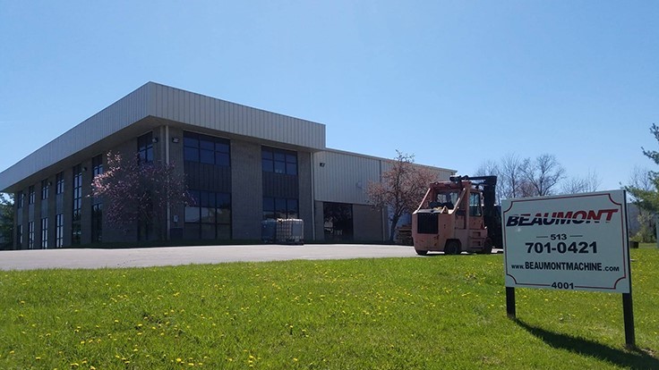

  • Beaumont Machine has relocated to a new larger manufacturing facility, still in the Cincinnati area, to expand the machine line for components for new markets such as semiconductor materials processing and land-based power generation, particularly turbine blades.

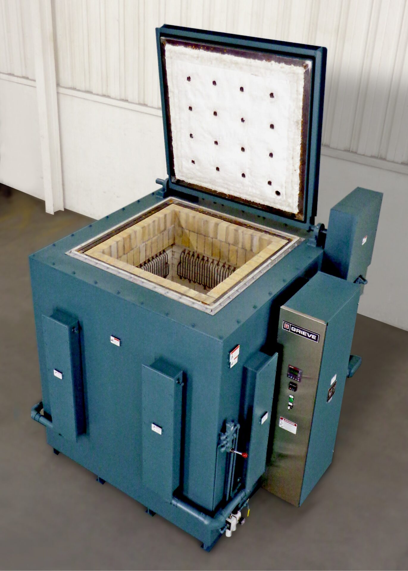

  • A medical device manufacturer required an oven to preheat an aluminum mold for a silicone part that was to be filled and cured in the next manufacturing step and contracted with Despatch. The company develops innovative products that improve patient outcomes by enabling minimally invasive surgery.

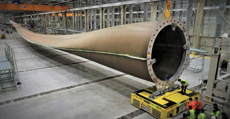

  • The world’s largest wind-turbine blade—351 feet (107 meters) long—has been manufactured by LM Wind Power in Cherbourg, France, as part of a GE Renewable Energy Haliade-X 12-MW offshore turbine. The blade is comprised of multiple thin layers of glass-and-carbon fibers with wood, fused together with resin.

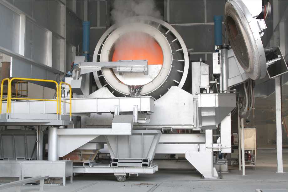

  • In addition, the largest rotary tilting furnace in the world has been manufactured and supplied by GHI Smart Furnaces, in a project subsidized by the Basque Government in which the company has worked together with Befesa and Tecnalia. This is the second time the company has reached a world record.
